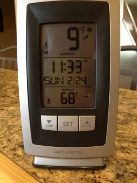

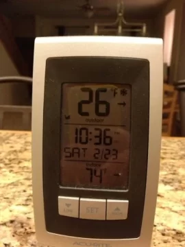

    I still think something's up. This is my current status in nearly 1970 sq ft. It's been on low the last two hours. Ill switch it back to medium and let the tstat take over for the night. I've been to -15 this winter and never a worry. I ran it full bore those nights but we made it through. I'm also two stories. No vaulted ceiling and my floor plan and stove placement work great luckily, but almost 2000 squares regardless.

    This was our result last night. Both numbers are lows. The stove stat was set on 71 with a 2• swing, so it went on call at 69, probably lost a degree during start up but never more than 1. It was on medium all night. Woke up this am to 73.
    Personally, I think having my ceiling fan turning the proper direction has improved our results greatly. I turn it off for a couple hours in the evening to let heat travel upstairs, but leave it on for the rest of the day usually.
