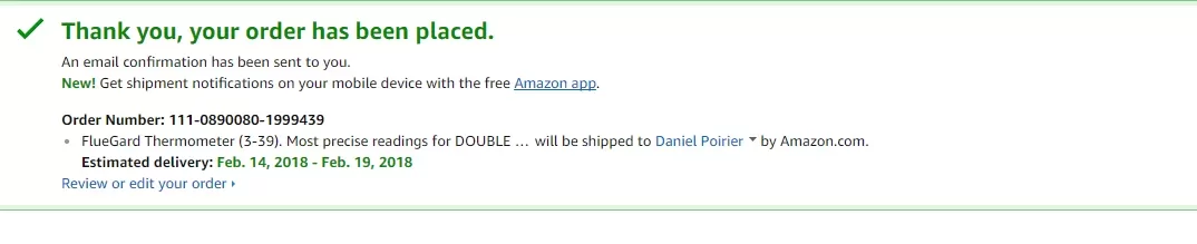

Ordered. Since it fits in the newbie subject of this post, and I am a total newbie with probes, what probe temp I should aim for during startup and what temp should I aim for during the main burn cycle?
