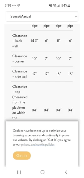

I'm looking to get my 1st woodstove installed in a couple months. sales guy told me I don't have to worry about clearance to wall behind it, but I'm skeptical.
Total width of space is about 60" and the stove will take up about half of that, so about 15" on each side. This space has a large bookshelf on each side of it. Yes, there would be combustibles on the bookshelf....
I'm thinking the chimney chute must get pretty hot and would damage the wall, as well as the stove itself & the hardwood floors.
I'm looking into a ceramic wall accent & hearth pad, or is this even needed?

This is what you should probably do.. take the measurements of the stove and cut it out on cardboard.. place ut in the area.. most stove stores don't go out to the house and basically go off of the basic information a new stove owner gives them.. You should print out the install portion and measure it out to the combustibles.. as the picture taken below shows its stating 17 inches

I just re-measured the space. I actually have 63" between the bookshelves. Minus 28 (it says 27' width) for the stove leaves me 17.5" on each side, so just at code for Canada (why would it be 16" in the USA, is chit less combustible down there?)
But I'm worried about the bookshelves themselves (say that 5 times fast!) plus the books/picture frames on the shelves.

The Osburn 2000 is 27" wide. A 60" wide space would have 16.5" side clearances for this stove with single-wall. This measurement is under the 17" clearance requirement for Canada. Too close. Canada tends to rate clearances a bit more conservatively, which is a good thing, imo. The rear clearance can be reduced from 14.5" to 6" with double-wall stovepipe.
The Osburn 2000 is a wide stove. There are narrower stoves that load N/S and have lower side clearance requirements. The 25" wide Quadrafire Millenium 3100, 28" wide Lopi Evergreen, or the 24" wide Pacific Energy Super have better clearances.

Just devise some side shielding for the bookcases and stick with the stove you want. There's a table in the manual that shows dramatically reduced clearances with shielding.

True. If proper NFPA 211 shielding is attached to the sides of the book cases then the clearances could be reduced. SBI sells the AC02710 shields for this purpose though at 23" wide it's unknown if they would fit the bookcases. If not, they would need to be custom fabricated by a sheet metal shop. They can be painted to be less visible.

I think 24 ga is what is recommended. Heavier does not offer more protection. 26 ga works ok. I have actually tested that. The main thing is to have a ventilated air gap behind it. That is what is doing all the work.
So what I'm leaning to is somekind of ceramic tile on the wall as an accent between the bookshelves. That at least provides some protection too from the stack.
That is offering no real protection unless there is the ventilated air gap behind it. It also doesn't qualify for clearance reduction. It would be better to have a sheet metal shop make the shields. The can add a 1" 90º bend on the long front edge so that the open gap is not showing. Paint the metal to blend in as trim on the bookcase ends.
