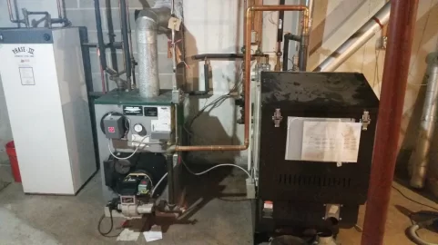

This is my first post. Here's my story. I purchased my house about 4-5 years ago. The previous owners had a Harman PB105 installed with the existing oil burner. The owner gave me a VERY brief description of the operation and cleaning. The first year went ok burned from December till sometime in March. I had the boiler cleaned/serviced by the dealer. The following winter is when the problems started. The boilers don't play well together. I loaded the hopper of the pb105 just like the previous owner said and I went away for a weekend. I came home to a 50 +/- degree house. The hopper was empty and the oil burner wasn't running. 3 thermostats were calling for heat and nothing was happening. Over the last couple of years when the zones call for heat nothing happens. When the temperatures are somewhat mild the boilers seam to work ok. When it's cold I have issues. This is just one of the issues I've been having. I'm now questioning if everything is installed correctly. My house is a Ranch around 2000 square feet, pretty well insulated.

Chris, I had the same [almost] setup with a Harman wood boiler, except for creosote issues, it ran flaw-lessly for 16 years. I don't know what the black iron T is for on top of yours though, it would seem to me to allow hot water to just circulate through the Harman & not go through the oil boiler? On my setup, there was a Taco 007 in that loop between the wood & oil boiler, when the water in the Harman got to 140F, it clicked on and ran, all the time, when it dropped below that, it shut back off. The oil boiler had a standard box on it like yours, the low was 130, the high 160. The Harmans aqua stat was set at 150 to open the draft door, 175 to close it.

Looks like a parallel setup in place now - but is there another circ we can't see, maybe inside the pellet boiler somewhere?

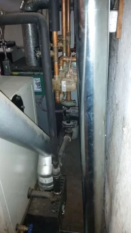

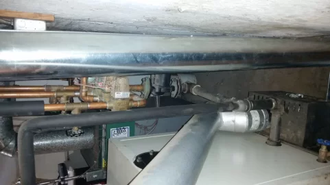

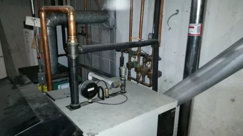

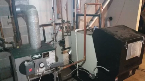

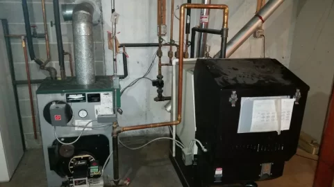

Just going by these pics, I don't see how this setup could ever work, the tee on the back, and the one on top of the Harman will just let hot water flow in a loop, but the loop should go through the oil boiler, but it doesn't. The zones on the back should feed off the oil boiler, but they don't. I think you need a plumber that understands these setups to come out and re-do it. It just makes no sense to me the way it's plumbed. [Hearth.com] Newbie..... well kinda.
That's kind of why I was asking about another pump we can't see.
Pretty hard to nail things down with net pics.
I think it would work the way it's plumbed, if it's controlled right. The way I see it, when the zones are drawing, the water has to to through the oil boiler - the water would get pulled through it. But there would need to be another pump on the pellet side to divert/pull the flow through the pellet boiler when it was burning.

Are the zone valves that we see in the return side of the zones? Looks like that to me. So where does the supply to the zones come off of? Can't pick that out in the pics.
Zones are plumbed off back of pellet boiler. Boiler feeds oil burner I think. When it's really cold out I have the problem of the zones not getting hot when calling for heat.
