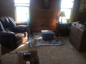

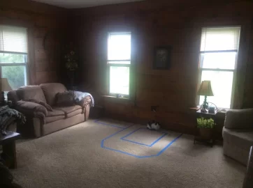

My other dilemma is where to locate it in my living room, I've got room in both the corner and a side wall. Either location will require an outdoor chimney install. I've attached some pictures of trying to lay it out based on the stove requirements.

Welcome to the forum!
The 30NC is well-liked here as it performs well especially for its price. It is not any more easy or difficult to operate than any other EPA-approved wood stove. The key is using dry wood with an internal moisture content of less than 20%. Do you already have several cords of wood split and stacked sitting in your yard? The 30NC has 3 cu ft firebox and you should come home to a still warm albeit not hot stove with plenty of coals for an easy restart. If that will be enough to keep your house warm the entire time will depend on the level of insulation, outside temps, movement of the warm air in your house etc. Nevertheless, I would expect the 30NC to make a major dent in your propane bill.
Both locations should work but make sure to observe all clearances, especially with all that wood paneling you have on the walls. The 30NC has heat-shields which I highly recommend using in your case. Exceeding the minimum clearance requirements is also never a bad idea. Be also aware that the stove needs a hearth with a r-value of 1.5. If you want to build your own here is a list of common hearth materials: (broken link removed) A forum search will give you plenty of threads where people describe how they made theirs.
The stove should be sized to the area it will be heating. If the area is a closed off room with just a doorway then you may be better off sticking to a smaller stove. If the floor plan is open and there is an easy way for heat to migrate around the floor and perhaps to another second floor via an open stairway, then a larger stove makes sense.
What is the floor plan like? How many sq ft will the stove be heating?
The ideal location for the stove would be central to the floor plan and with a chimney straight up through the house. If the chimney has to go through the 2nd floor it can be chased or perhaps run in a closet or hallway and then chased. A straight-up chimney through the house will draft the best and will stay cleaner. If there are no other options besides running the chimney through a thimble, out a wall and then up, place it on the gable side of the house. This will look better, have better anchorage, and will hopefully allow enough chimney height for good draft. The two 90 degree turns that the smoke will have to take to head up the chimney will effectively reduce its height by about 3 ft per turn. This can be compensated by adding more expensive chimney pipe.

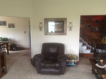

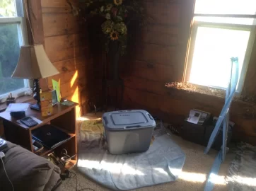

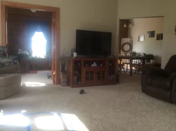

[Hearth.com] Newbie with stove and hearth questions [Hearth.com] Newbie with stove and hearth questions [Hearth.com] Newbie with stove and hearth questions
As you can see I was busy with the masking tape. This might give you a better idea of the layout of the house. I'm open to any and all suggestion as this is my first time doing this n there defiantly no room for do overs.
Looks like you have 1900 sq ft total. If some of the heat can go into that remaining 400 sq ft the Legend should be fine. Is one of the stove locations on the gable end of the house? If so, that would be preferable.

Since the box car paneling has been there since the 1920s I am going to go out on a limb and guess the building was originally heated with wood.
Can you find out or do you already know where the original fireplace/ wood stove was? What would you have to do to work with that? What I am getting at is probably somewhere in both your roof framing and the framing the second floor sits on is an existing opening that you might could uncover and reuse.
Might be where your cook stove is in the kitchen - it may be a non starter type idea - but I think it is worth a look. Probably the folks that built your home forgot more about would heating than everyone here put together knows.
While I have only driven across Illinois and the winter and never actually stayed there through the winter months, I remember it being cold enough that keeping your chimney inside the building as long as possible and making a single straight shot from stove collar to chimney cap are both worthy goals.
Setting a new stove where the brown leather arm chair currently sits would - to me - be worth moving an interior doorway upstairs and giving up 9sqft of upstairs floor space.

At one time there was probably a fireplace where the tv is currently located. At one time there was a brick chimney there because you can see the remains of it in the attic. Unfortunately there is nothing usable about it anymore and would need to be removed.
With the outside installation a cleanout would be easier I would think, no need to climb onto the steep roof to brush it out. Going straight up through the ceiling where I marked it at would place the chimney much to close to the bed upstairs.
