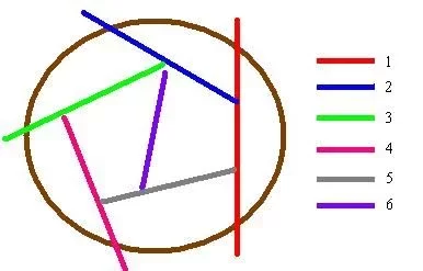

derecskey said:
Ah but what do you do with 30" rounds?
start at the edge and work around. every piece may be different, this certainly isn't the best order or the only order, just an example. it all depends on how big it is and how large you want your splits.
  • Newbie Wood splitting question!
Danno77 said:
Is it important to use the same colors when scribing the log?
Yes, KC. Although other's might suggest crayola sidewalk chalk for their markings, I ALWAYS use sharpie brand permanent markers. What happens if you leave the round for a day and it rains? you'd never know where to pick back up at!!!!
I am in no way affiliated with Sharpie brand markers and profit in no way by promoting them. Although, if more people buy them, then they will perhaps drop prices and I can buy more to sniff....I mean draw.
