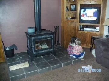

I used the "dead air space" method as described in the heritage's owner's manual plus two layers of durock and then my tile.
This stove is heavy and you don't want to cut corners and have to rip it all out.
