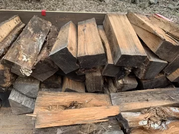

@Ctwoodtick has some great advice on running the stove.. one of the things that i have found is how the wood is split as well as the type of wood. The more BTUS in the box the more heat you get out of it. Its also how you split your wood. When im splitting i make regular (pie shape) like everyone else . But also split specifically for my overnight burns. So when running the splitter i will split in squares.. like 4x4 .. 5x5.. 6x6 and so on. This allows me to stack and fill the box fully with out alot of airspace. The more wood the longer the burn.. the thicker the wood the longer the burn. Iv gotten over 14 hr burns in my stove with this method. When im bringing wood into the house. I have 2 racks by the stove. 1 for day, 1 for night.. the square ones go in the night rack. The others get burned during the day.. thick wood and packed tight = maxim burn time..

Mine might be more rectangle than square, but if anyone is wondering how I get 36 hour burns out of a stove rated for only 30 hours, this is probably the reason for it.

Saw last year that your loadd had a lot of square or rectangular pieces compared to triangles so this year i figured i would give it a shot. I wanted to see which would take longer to burn and which would season faster.

Good idea. Oak lends itself especially well to splitting like this. Can’t tell if that’s what is in your pic.
Yep. Red oak, it’s about 90% of what I’ve burned the last three years.

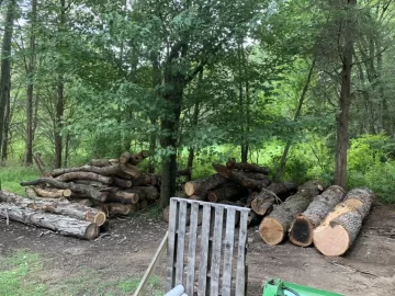

Now I seem to be in a run of hauling white oak and hickory, all depends on where I’m harvesting.
[Hearth.com] Night burn
Scale is tough to perceive, those logs are all 15 feet long.
Man you have such bad luck. Red oak normally, but you poor guy, now you’re finding white oak and hickory. Tough break ;)
I love hickory. They stay healthy around here though. Hard to come by. I have about 1 cord of shagbark ready for this season. Been drying for 3 years. The rest for this year is red oak, cherry and ash. also 3 years dry.
We had a tornado rip thru, and tear down about a hundred cords of white oak, and another hundred cords of other mixed hardwoods, mostly hickory. Bad news for our local shady picnic grove and adjacent woods, but good news for anyone who can make use of white oak and hickory. Another buddy down the street had the same tornado tear down a dozen very large ash trees, which I may fetch this fall, if I can find a place to put them.
