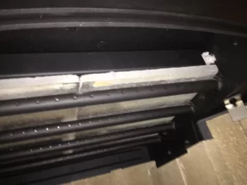

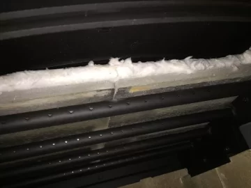

Thank you for the welcome. The stove was just installed. kind of wish they lit a fire before they left. Difficult to tell on the blanket. There is a metal angle iron over the end of the blanket. The angle iron is removable. Is that supposed to be there or is the end of the blanket supposed to be exposed?
Probably not but I don't know that particular insert well enough to tell for sure. You could maybe check on the blanket by holding a camera phone up there and taking a pic.

The first picture shows the angle iron that is around the edge of the blanket. The second shows the blanket with the angle iron removed.

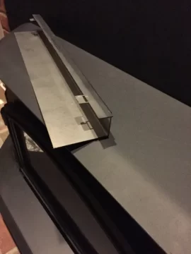

The angle iron can go either way, you can leave it in there where it is or remove it. It doesn't matter.
Personally I'd leave it in there. I think QF did this because you have a split baffle board.

Being you have the 5100i, did you see my picture of the baffle blanket and the one with the angle iron that is there? I have a feeling that was supposed to be taken out.

what are the dimensions of the angled metal? 1" x?

Good to hear that it seems to work for you now. Once it gets colder you may not need to prime the flue as much anymore. And running the insert 24/7 will certainly also help with that. However, I would put that angled piece back. It is probably there to keep the blanket in the right spot. Not sure if your draft could get strong enough to suck up the blanket but the piece may also help against that.
