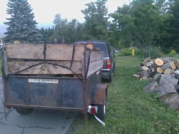

See if you can get something with high sides. I got a good deal on an old rusty farm trailer, put a little money and tons of elbow grease into and I got a decent trailer. Nothing fancy just a nice wood hauler.
The high sides are great toss stuff in there, no tie downs/tarps required.

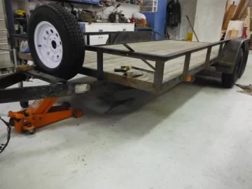

A cord of green oak weighs around 6,500 pounds. Before you start jumping up and down thinking you will be able to haul a cord of wood if you have the 5.0 liter engine, you will need to deduct the trailer weight from the 6,500 pound towing capacity of the vehicle. Guessing that the trailer will weigh 1,000 to 1,500 pounds since it will most likely be a tandem axle. So, you might be able to get 1/2 to 3/4 cord on a trailer.
Here is a 7,000 pound GVWR utility trailer that can haul 5,400 of cargo, so it weight 1,600 pounds.
