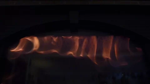

Has anyone ever had a burn happen in their tube stove/insert like the below video?
I've had these northern lights-ish secondaries before but typically only briefly and kind of sporadically...this time it lasted over 30 mins burning exactly as in the vid with NO primary flame visible.
Insert top (there's a spot on the Montpelier top that is exposed so can get real readings) held at about 650 during this time despite the very slow and very small amount of wood gas burning.
