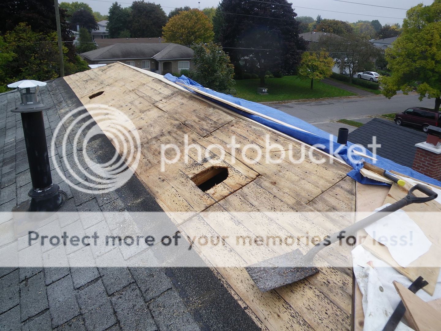

    If you want to know just how good you got it, spend a day or four wearing another man's tool belt. I'd say roofing is one of the three toughest trades in know of, just after concrete work and just a tad harder than concrete block work. I'm glad I don't do this for a living.
    The old shingles come off:
    Hey, this isn't so tough. If the rest of the job goes this easy, I'll be done in no time.​
