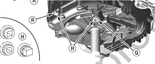

I have the same motor on my speeco as my dad has on his huskee 22 ton and the oil plug is on the underside of the motor right next to the hydro pump bracket. The only diference between mine and my dads is mine has the allen hex female style plug and dads has the 1/2" square male style, yuors could probably be either so look for both. Nate
Ive never seen a motor with out a drain plug . Some are Allen head bolts in the side of the block . Some are under the motor as said before. I have a ton of equipment and find it hard to get all the maintenance done every year on time . We are usually just trying to get every thing running . I use am soil in my small equipment and i think it helps , in case you miss on some oil changes . I use a suction pump on my sail boat diesel but it draws from the bottom of the sump . I like to dump motor oil out the bottom so there is no slug left . John
You could always download the manuals for your model engine and look at the IPL or diagrams. Here is the layout for mine.

Mine does too now that I found it. Had to tilt it back to get to the plug, used a 3/8 universal socket extension to get into the plug. The dumb asses who designed this should have their b--- cut off. >:(
