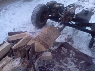

A buddy of mine came over today and hung out and then popped the question ! How do you do that !
There really is very very little since involved with this. Just split the round in half or quarters or whatever like normal and put the flat side on the beam and split away. Putting the round side on the beam makes it harder to control and does not help with square splits. The real squares happen when the split is to tall and needs to be split in half again. ;) They won't all be square but mostly uniform which is all I am after anyway.
That is ash that was cut at Dennis property last year and to my surprise it was lying in plain sight ! I thought it was the perfect piece for the demo ::-). Thanks Dennis my friend !
Pete
Pete
You are welcome Pete.
A true square split does not have the angle of a triangle. If that piece you are splitting in the picture were bigger, rather than splitting it down the middle, I'd split some off both sides. Then you'd have 2 triangles and 1 square. Like BB said, squares really are nice loading in the stove especially when it is cold and when you need long fires. You can pack them in tight that way.
Good point Dennis it is just set where it would not fall. It did not occur to me to point that out !
