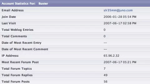

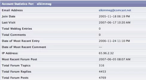

Buster, you seem to live next to Elk. Are you guys buddies?
In fact, you have the same IP as Elk....
BUSTED....for sure.....tell me it's not true!

Natururally while visiting my father Father's day I use his computer it no secret, Goose knows I'm Elk's son. I posted it this way so there would be no doubt
Buster is the familly labador retriver
I think it was a secret to many (most) of us! To me, for sure!
Personally, I don't like the smell of Elk and you (his son) pushing a brand in a manner which suggests more than them being just another casual user....and, worse yet, berating people who buy stoves other than that. It goes against the entire spirit of both Hearth.com and the forum...
Please try to help people as opposed to pushing an agenda. PM me if you have any questions regarding this policy.
