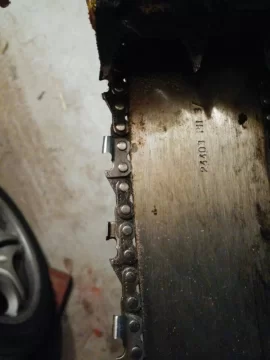

Ok, what do I need to make my saw cut better?
nola mike
Sep 13, 2010
956
Richmond/Montross, Virginia
Bought a Husqvarna 450 with a 20" bar last year so that I wouldn't be tempted to use my inherited 40 yo John Deere. Well, I thought it cut OK. Until I used the Deere. Man, that thing kicked the crap out of the Husky. I still don't want to use it because of the lack of chain brake, and the Husky starts easily and has nice manners. But I need some more power. I'm going to start with a new chain. The different types are making my head spin, so maybe you guys can help me figure out what's on there now (and on the Deere) and what I need. Also was looking at getting a shorter bar--how much of a difference would going to an 18 or 16 make? Here's a pic of what's on the JD; the Husqvarna is the stock chain.

Not knowing what size your 40 yo saw is it's impossible to compare. I'll take your word that it cuts better. Also can't make out much in the picture.

The chain in the picture you posted at the top of the thread is semi-chisel, because the bend from the vertical part of the tooth to the horizontal top plate is rounded. On a full chisel chain that corner would be sharp; a section view from the front or back would look like the numeral 7.

If you are not sure what you have, remove the Husqvarna's bar, and post a picture of the markings stamped on it.

Ok, still researching this, here and at arborist site (my wife, not for the first time, is wondering what's wrong with me). Here's what I think I want:
1. 16" bar, lots of options, not sure whether it matters. Should I get a NK bar, just because it can run either chain?
2. Oregon LPX (this is the same as the "20-series" chain?) or Stihl RS. Are either of these available in NK?
3. NK v. regular? Seems like NK should cut better--are they all low kickback though?
4. Full v reg chisel. I think I'll start with full and see how it holds up. I don't typically cut more than 1/2 cord (at most) at a time.
Someone feel free to give me a link to some specific products that would work with my saw. I want to make sure I get the right stuff. Here's what's on the husky now:
[Hearth.com] Ok, what do I need to make my saw cut better?
