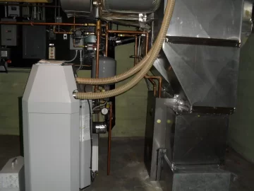

We just had the MeSys boiler installed in July, replacing an aging oil boiler. The heating system is forced hot air with central AC which we retained, requiring a heat exchanger for the boiler. We are running DHW off the boiler into an 80 gallon tank. So far, so good--although DHW is the only thing we've heated thus far. We also noticed a very slight smoky the first week or so which has now disappeared. The house is a 50 year old cape with new insulation and windows, about 1700 sf. We're looking to improve over the $3000+ we spent last winter to heat the place. We removed the original oil furnace and oil tank and will be using the pellets as our sole heat source. We went with MeSys because our local HVAC guy, whom we know and trust, installs them (we are his third install, oink oink said the guinea pig). We received our Efficiency Maine rebate check less than two weeks after the installation, and they didn't even schedule an inspection until the end of September!
Yes the check comes quick from Efficiency Maine, we skipped the inspection as it is optional and didn't want someone snooping around. Interesting that you kept the FHA, I would like to see pics of the setup if you have any... we decided to go with radiant as my lovey wife has allergies and we wanted to get away from it. We still get the smoke from time to time... Q: on the back where it vents to the chimney, is your pipe around the outside of the boiler flue pipe or tucked into it?
We kept the FHA because we wanted to retain the central AC--if we couldn't do that we might not have made the switch. I'll post some pics within the next day or two. I don't quite understand what you mean about the boiler flue, but I'll try to post a pic.

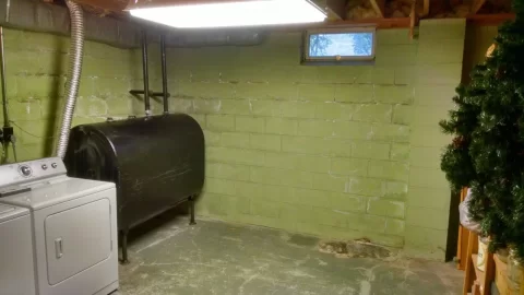

Here's our original fuel tank....
[Hearth.com] OkoFen/MeSys Install

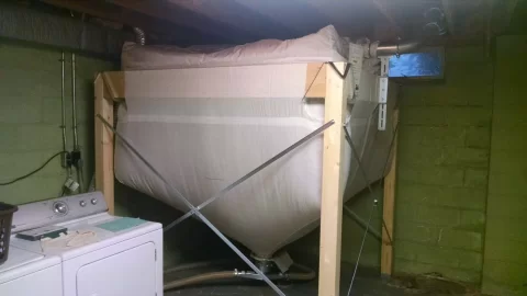

Replaced by the 3.2 ton pellet storage bin...

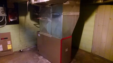

The original oil furnace...
Now replaced by the pellet furnace and heat/ac exchanger...

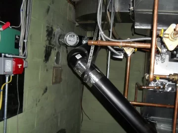

And the flue pipe...

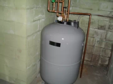

Here's the 80 gallon hot water tank, heated by the pellet boiler...

Your flue pipe is set up the same way, its inserted into the boiler rather than around it... however mine is not taped... I have some of that foil tape from another project, I think I might tape up the joints to see if that helps.
Very nice install, for being a guinea pig, :) That water tank is huge. Are you running it at 140F with a mixer to bring it down to 120F? You must get over 100gal of hot water that way...

I think I found part of the problem....
Yep, does look like you found it. Our installer recommended our hot water tank for two reasons....(1) the pellet stove gives a bit slower recovery than oil or electric, so with 80 gallons for two people we should be good. (2) The first installation he did they used a hybrid hot water heater, but since then he (and MeSys) decided it was better for the boiler to run periodically than shutting down for three or so months (remember, guinea pigs here). I checked with my insurance agent before we pulled the trigger, and I was told that our insurance would not be affected. According to the agent, our insurer--Maine Mutual--is the only company in the state that does not require any policy changes for pellet boilers. So says the agent. :-)

No it looks like its just barely in there... regardless it is now taped up with some foil tape.. we will see how that does..
With 2 people and our 45 gal tank we have been doing ok.. even with 3 people in the house taking showers back to back it seems to cope. The tank temp is set to 140F. The real test will be in a month or so we will have 4 people here taking showers... we will see if the last one in get a... refreshing... shower. ;)
