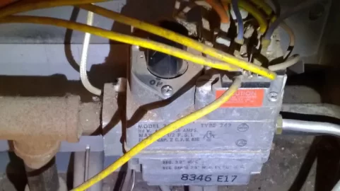

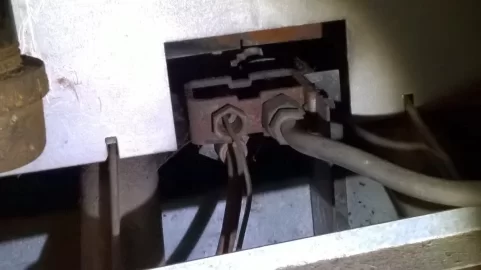

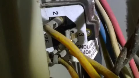

[Hearth.com] old 80's arco air pilots lit but no burner action [Hearth.com] old 80's arco air pilots lit but no burner action [Hearth.com] old 80's arco air pilots lit but no burner action Here are pics of the thermo coupler / pilot, mercury switch and gas valve.

Thanks for the help. I just went ahead and started jumping things. I jumped the mercury switch and the gas valve a few times they sounded like they were engaging. Then I called for heat and the burner kicked on. I think I may have just had a sticking valve. This furnace hasn't been used in ten years as I've been burning wood pellets. I bought propane this year because it was cheaper then pellets. I've got lots of carbon monoxide alarms around so if things go south hopefully they alert me.
