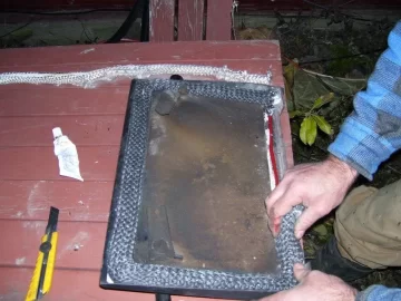

To try and help as I had a similar situation as you with a 30yr old BK at a house I was staying at while I was working out of town for 3 month's. Since the highs for most of the time where -30 I wanted to make things right with the stove.
#1 was the door gasket was pretty much compressed and at the end of its time. I had the new door gasket shipped in and replaced it with the new BK era thick wide gasket. In the photo as you can see that in the corners I did not streach the gasket but actually bunched it up in those areas as the stove corner lips are quite square. Now upon removal of the door I found a crack on the stove upper top left hand side. it was long but not separated. After re assembling the door and lighting the fire I noticed better control until it heated up. That crack was opening more than a 16th which was enough for me to see the flames.
Being a pipefitter/welder the next step was easy. Next day I was able to bring the welding rig back to the house and removed the door once again. All was ground down and I heated up the stove area so the expansion and stress in that area was removed.
Filled the crack with 7018 uphand with a filler 3/32 and larger woven cap with 1/8th. Reassembled/ Popped on the door. The stove was once again a new animal under control. The lady of the place we rented from still crosses my path now and again as I go there to do some spectacular fishin. 3yrs and still together.
Thanks for the detailed response. Do you happen to remember what size that gasket was? The widest I can find around here is 3/4 at the box stores. The local fireplace shop was out of 1". Can't really tell from you picture, but it looks like 1" or more.
My gasket is compressed pretty bad. After she cools down a bit I'll try a dollar bill test but I don't see I'll be able to do that on the bottom (suspect area) since this is the old drop door type stove.
Before I lit the first fire in this stove (4 burning months ago) I gave it a detailed inspection for cracks. I didn't really expect to find any since the stove, while 25 year old, only had a handfull of fires in it before I bought the house.
Gee, this stuff was 1 1/4" by 3/4". Came from the BK dealer right out of the metropolis of the north. (Whitehorse) :lol:
