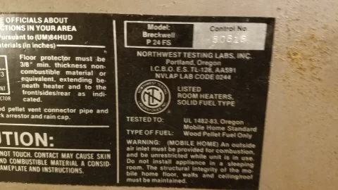

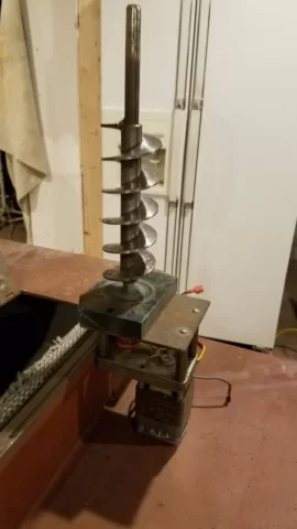

I have a 1988 Breckwell p-24 fs. Everything has been working fine. Well, originally the auger was jammed, seized to the bushing on the end of the auger. So, I pulled the auger, and cleaned the end of the shaft up. Its been working ok for the last month or so. Now, randomly, the auger will jam up. I have a feeling the bushing at the end of the auger needs cleaned up, or replaced. I took motor apart, cleaned it up, lubed the gear box up. It seems to have the power to work ok. My question is. Should I upgrade to a more powerful motor? If so, which one? How do I replace the upper bushing? Looking at it, it looks like its steel? I would imagine brass would be better. I don't know how to remove it. There are no threads that I can tell. Is it just press fitted in? Do i need to fab up a puller of some sorts? I included a photo of what it looks like out. Thanks for any info.

Should be a brass bushing in the top and bottom
I haven't found a bushing on the bottom. It runs thru a teflon block, straight to the shaft that comes off the motor. The bushing at the other end, appears to be steel. Problem is, I have no way of removing it. As far as I can tell anyways. If I can figure put how to remove it, than I can change it to a brass bushing, or a sealed bearing of some sort. Any ideas? This is a 1988 model. Probably one of the first models. Thanks.
Someone has modified that stove at some point im betting. Looks like that block has been cut with a hand saw. If it was me i would order the replacements and once i had em in my hand i would try to figure out what the stock config was.. Steel on steel is just going to wear out fast and rust together when not in use.. The nylon is probably getting warm during use and gluing to the shaft when not in use when it cools down...
