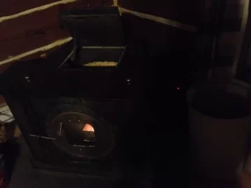

Hi , this will be my first ? on here. I have an old Dovetec which i have been using for 5yrs.
This year was not good it has been burning dirty and smoke is trying to go up the hopper chute.
I have cleaned and vacuumed a lot but still not better, when i check behind the back wall i feel a lot of white ash
I suspect the chambers are all blocked
My question is can i take the stove outside and blow with a blower thru the back of the it to blow ash out.
any ideas on this

Thanks for the reply, i will get hubby to drag it outside this summer and i will clean it up pull off the blowers and try to find a way to the chambers....i do have a manual but it has no valuable info in it.
she's working fine once again , thanks all
