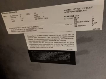

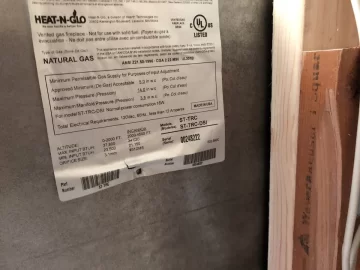

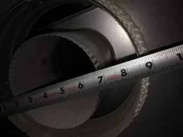

Hi all! I am in a bit of a bind. I have a 16” run off of a Heat N Glo ST-TRC and need the venting and term cap. Willing to use any combination of DV-06D, DV-12D, or DV-24D venting (or adapters and new venting?). Term cap is part DVK-01TRD. Thanks!

View attachment 280512 View attachment 280513 View attachment 280514 View attachment 280515
