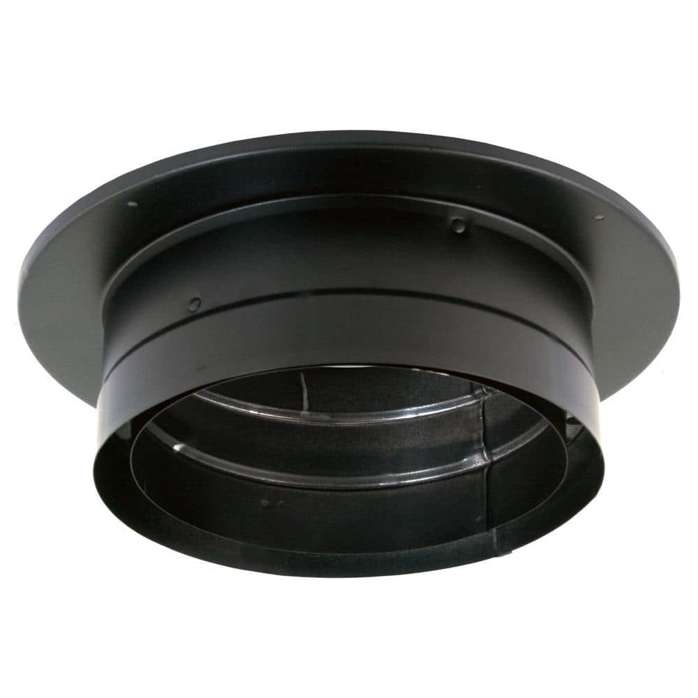

Back again for advice, i bought the 6dp-ktup ( 1st photo ) kit as 1 we simply cant afford the more expensive version and 2 the incoming freeze for the south. im low key panicking now to get this in , in a week. the hearth will be cured enough to put the stove in its final position friday, then i can try to do the roof myself as i have had no luck getting anyone in for a quote.
as i have the DVL double wall stove pipe would i be right in thinking i need the DVL6 adapter to go from the double wall pipe to the transfer box?

The kit contains the adapter already. It's in the bottom foreground of the picture on the box.
In my experience the chimney pipe adapter is the same, no matter of the stovepipe is single or double wall...but maybe that's brand/model dependant?
2-types of stove pipe adapters are included to give you the ultimate flexibility in what products you use with your duraplus chimney
the adapter that came with the kit simply will not fit in the DVL pipe either way.
This is the part.

dammit youre correct ( figured you were which is why i was worried ) i just looked again and that part is missing, i mistook it for the chrome insert that goes inside the single wall part, totally missing the DVL writing .
my apologies, i guess ill go back to tractor supply and hope they have another kit.
What "chrome insert" goes into the single-wall?
sorry its been a few weird days, single wall pipe adapter i meant, Tractor supply confirmed the part was missing, and their spare kit in stock....................... is also missing it sigh, they called to make sure it should be there, and it should be, so one is being shipped from the warehouse to me. now all i can do is wait . well after i finally move the stove onto the hearth tomorrow.
