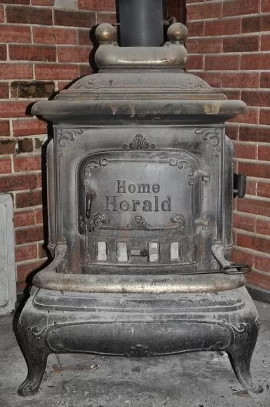

It’s definitely a wood stove and there’s room for another log or two but yes, the splits we have are pretty beefy. It’s our first year doing wood heating so we’re getting the hang of this. It is definitely a wood stove based on my research. Pic of similar stove I found online.
I can't tell from that pic it could be either one. What does it look like inside?

Insert in your previous thread a part that says home herold wood. So it atleast had a wood conversion if nothing else

Firebox is big enough for 4/5 big splits loaded to the brim. There’s no ash pan below the cast bottom plate. I was pretty convinced it was a wood stove until you guys started talking about coals now I don’t know. I always thought coal stoves had a tumbler mechanic at to stir up coals and this one is basically just the fire chamber with a front damper and a door.
They do a coal stove needs a shaker grate with air coming from underneath. If yours doesn't have that it's not a coal stove at all

Yeah. No grate and no path for an air stream below the fuel. The bottom plate is a thick sheet of CI with a corrugated ridges cast into plate.

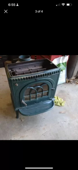

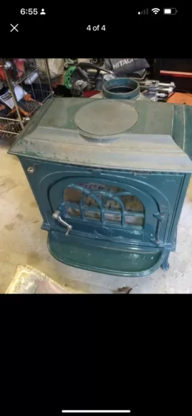

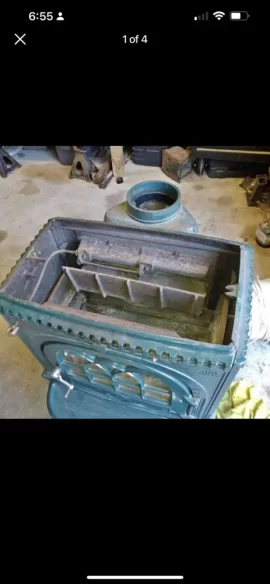

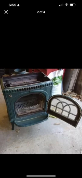

After scouring the market for a few weeks the leading candidate is a 2007 Jotul F400 in great conditions. At least per the pictures. Owner is asking for $1000, which doesn't seem out of line considering the other prices I'm seeing.
Do you guys have any input? It's burgundy which obviously makes it much more valuable...

Look really well at the base ppl are for cracks in the corners and ash grate corners. Make sure the baffle is straight. 375$ to replace. Check door alignment. You can replace the gaskets if you need to.
1000$……. For an enamel stove this year. I’d take it. It’s not big. 4-6 hour burn time. I love mine.

$1000 seems high for a 2007 stove. Is it enameled? I bought my F400 in blue-black enamel for $1439 back in 2006. Admitted that this was a good price. I got it on a hot summer day as a floor model in a very quiet stove shop. If not enameled, offer $700. If enameled, $800 cash.
