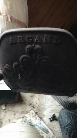

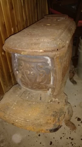

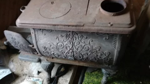

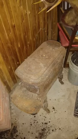

Here are two in the basement. Larger one was the main upstairs at one time. What do you make of these two?
You couldn't pay me to use either of them to heat my house. Stoves have come a long way since they were made
I don't know much about it but some of the old folks here shook their head when I showed the newer stove the previous owner switched from that old big one. Whats the main differences? I see the newer one is covered in fire brick all over plus some sort of shield up on the roof of the stove if you look in it.
Post a pic of the newer stove. There is about 100 years of development between those you pictured and current stoves. So newer covers allot.

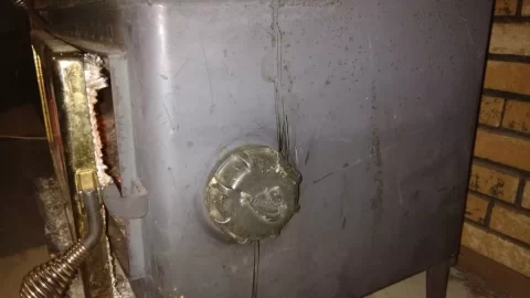

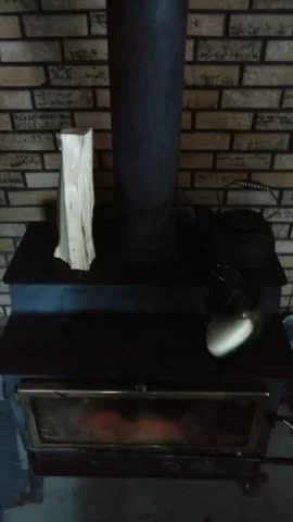

Newer stove

Is there a tag on it anywhere identifying the stove? Regardless even if it is a pre epa stove you will get way more heat from each peice of wood from that stove over the antiques.
Says warnock hersey at the back and stove master on the crank handles on the sides.
Warnock hershey is the testing lab that certified the stove. What crank handles?
Can you post a pic of the crank handles?

Yeah ill get pics tomorrow. All these comments about the old relic stoves can anyone elaborate on them and why they are so inferior?
They send a huge percentage of the heat up the flue wasting in many cases 2/3 of the BTUs available in the wood. Short burn times. Very little control over the fire.
The old stoves are awesome easily sellable for cabins , garage heating , or ice huts , but your airtight is much easier to control and damp down for an overnight burn .
