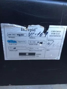

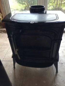

Hello,
I've recently purchased a second hand stove and I need to find a user manual for it.
I believe it's an old vermont castings intrepid/intrepid II and I've tried to search online but unfortunately cannot locate the user manual for the model stated.
I've attached a picture of the stove and the i.d sticker that it has.
Can anyone point me in the right direction of the manual?
Thanks
CG

This appears to be the old Intrepid B Vent Gas model, which was exclusive for the UK. All it had from VC was the Intrepid Stove shell, as far as I know the gas 'guts' for the unit were provided by a company from England called 'Kinderfire' (bfm europe). I would look them up, as the manual was likely proprietorially theirs.
www.kindergasfires.co.uk
Reactions: FLAMES ON
Tech Guru, Nice catch on that. Not even in the VC archives.
