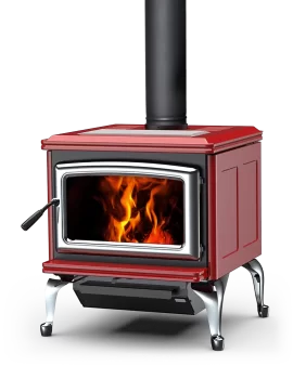

Sounds like the whorehouse red Summit is a candidate. WOW factor along with efficiency.
