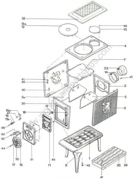

Mine is a pre-UL model, I think circa 1983? It has the bottom burn plate. Here is a diagram of the 602. Part #35 is the bottom burn plate and #34 is the insulation blanket. If you vacuum out the stove bottom you should find the retaining bolt a few inches back.

This is getting curiouser and curiouser. I scooped aside the ashes and see what appears to be the insulation blanket but there is no bottom burn plate with the wavy lines.
Can the stove be operated safely without it if I have sufficient sand/ashes in the firebox? Can I add the bottom plate if I can find one second hand?
According the the Jotul manual I found online, not all 602s were so equipped. See the notation on the diagram on page 5.

Clean out all the ashes and vacuum out the stove. Then look for the bolt hole. It should be for a 10mm bolt. I don't think the stove is meant to be run with ashes directly on the bottom insulation blanket. Without this burn plate there is going to be much more heat directed toward the hearth too. That would change the hearth insulation requirements one would think.
