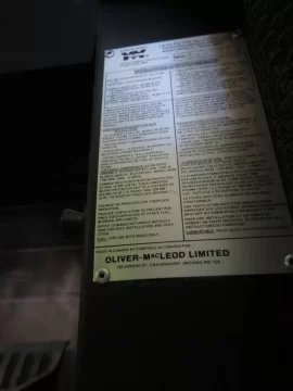

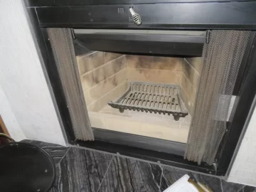

Anyone have any installation / owner's manuals for an Oliver MacLeod factory built fireplace model Regal 3438, prox age 1984? It is installed in a condo in Toronto, Ontario. Manufacturer was originally in Gravenhurst, Ontario, out of business.
Thanks for any tips.

Any chance you could take a better photo of this manual?
No can't take better picture it was a jpeg sent to me by client but it was zoomable on my phone when I uploaded it client since sold it sorry

As this unit is over 25 years of age, it warrants replacement, ESPECIALLY in a Condo application. All the clearances on this unit MUST be observed at 1" from the standoffs on the unit. and 2" on the chimney system [which is most likely OM Projet Chimney]. It was common back in the day for the contractor to insulate around a unit. If you are doing a WETT Inspection for Code COmpliance I would STRONGLY recommend a Level II inspection and the use of a Boroscope to see in behind this unit and to check the clearances on the chimney inside the compartments. We have seen too many from this era installed incorrectly, As a matter of fact we just shut down an entire complex because of the clearance issues.
