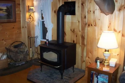

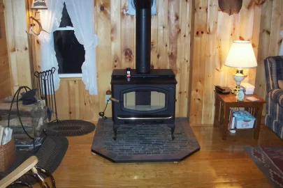

Here are a few
  • [Hearth.com] olympic stove
another
