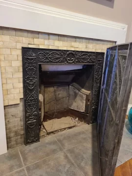

We have a foursquare home built in 1898 with an original brick fireplace in the corner of the living room. Chimney extends into the basement and runs through the master bath on the second floor, a closet in the attic then out through the roof. It is currently not lined, but aside from needing a bit of repointing in the attic, it seems to be in fine condition. Brick hearth is intact in the basement (we'll be replacing the ugly floor tile and hopefully restoring the original wall tile surround). The fireplace itself is on the small side, with the opening inside the original iron face frame measuring just 22"wx25"h. Not sure whether the existing fire box is original or not, but it is in rough shape and would presumably need to be replaced. Here's a photo:

You would need to pull out that old coal fireplace to see what the actual firebox size is behind that
Reactions: clancey
old coal fireplace
Is that what the iron and cracked cement (I think?) thing is? I had no idea...no wonder I'm confused! 🤪 I'll have to enlist DH's help - will return with correct depth measurements once we figure out how to remove. I think the white thing floating above it is a piece of styrofoam the previous owners shoved up there. Little wonder we keep the entire thing covered at all times!
Yes that is an old insert of sorts but there are lots of parts missing.
There are a number of manufactures that make cast iron and cast iron clad inserts that would look close to period correct.
Yes but finding one that fits is the problem

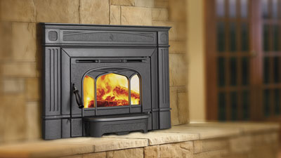

Minimum Fireplace Opening*
Width (front)25 in.
Height19 5/8 in.
Depth15 in.
Dimension Notes: *with standard flue
Thanks armanidog. I saw this one, but it looks as though the width is just a few inches too large for my 22" opening. Unless that iron face frame is part of the coal-burning insert that is going to have to be removed anyway and there is a larger opening hiding behind?
The cast iron frame it part of the insert
Well, that's a bummer, isn't it? I love the look of it and I would really like to preserve as much of the house's history as possible. I wonder if a fabricator could use it to create a custom surround for an insert?

I have done a few gas units where I used the old coal surrounds modified. The proportions of wood inserts generally aren't right at all.
I've been looking around online and that definitely seems to be the case. I've found several UK-based sites that have suitable options, but they don't seem to have US distributors. Anyone know where I can pick up one of these? https://www.stovax.com/stove-fire/tiled-convector-fireplaces/victorian-tiled-convectors/
What type of repairs would I be looking at if we tried to use the coal surround converted to gas? Or is ours too far gone?
You would buy a valor gas insert and find a fabricator who can modify the surround and fabricate missing parts
