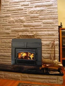

Thank you for the reply. Here are the pictures ... Obviously, without the insert
This link is to a sample of what the Jotul looks like ... I'd basically need a 4" filler panel above the surround to reach the 31" height of my firebox
(broken link removed to http://tinyurl.com/ypguo5)

I would second the idea of raising the insert up on fire bricks and facing the bottom. You could either use a piece of metal to match the surround, or some rock or stone veneer to match the existing.
I love Photoshop ... and I think I agree with you both on raising the insert up and filling beneath it ...
  • [Hearth.com] Options for undersized insert trim kit

It may just be me, or the perspective of the photos, but it looks like that fireplace doesn't have much (if any) hearth sticking out in front of it - If so you should plan on building some sort of extension so as to get the code required 18" minimum clearance in front of the loading doors...
Gooserider
Yeah, it's the perspective of the picture. The hearth is 20" wide.
