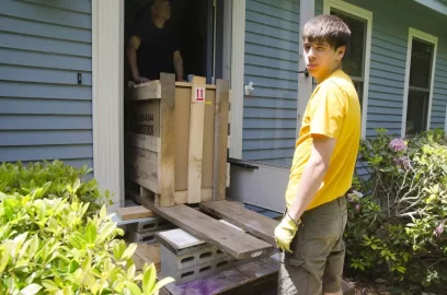

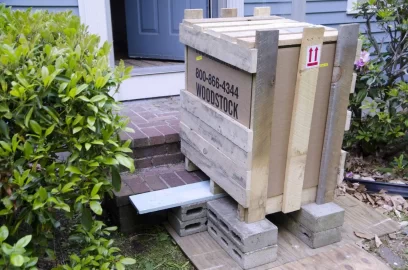

I have a really bad back, but managed to move a 500 lb Woodstock Palladian up a bunch of steps with the help of my 15 yr. old.
We did it with old fashioned Egyptian ingenuity, using ramps, building platforms, sliding and tilting the stove up each platform. We never strained once and saved about $300 instead of hiring movers.
