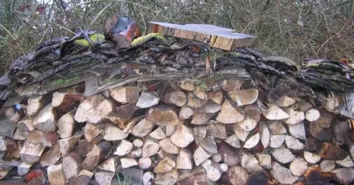

It probably doesn't matter much, but I try to put the bark side up on the final upper 3 course of splits on the stack. Then I take the large slabs of bark (soft maple or doug fir) and make my top covering out of them. I lay them down like roof tiles, alternating seams, about 3 layers thick. This looks better to me than a tarp and seems to resist the wind fairly well.
Ah, then I'm not nutz %-P I've been stacking with the bark side up. I figured the bark might prevent, or lessen the amount of water that might get into the wood when it snows or rains.
I like the idea of your bark roof tiles. Never thought of putting the bark on top of the stack but it makes sense. Now I know what I'll do with all that loose bark around the wood pile :-)
I just have a piddly pile of wood that didn't fit in the shed sitting outside right now. Here's a shot, in the rain, of the pile with it's bark roof. The nice thing is that the bark stays in place, even through some pretty good gusts recently in the 25-35 mph range.

that's pretty much what mdf and particle board looks like on top of a pile all Winter.
It ain't pretty but it beats tripping over it. It's cheap, it's plentiful, it's free.
If it falls off it doesn't have to be picked up or aknowledged.
