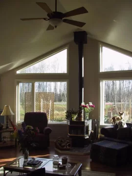

The technical term escapes me but as you can see from the pic I posted the chimney is only used by the one stove, has no angles and is a double lined chimney and sits just over 4 feet above the roof line. I might add I we had a very expensive cap on it that is designed specifically to not allow down drafts.

By saying chimney we are led to believe its masonry which usually has one or more flues. :)
