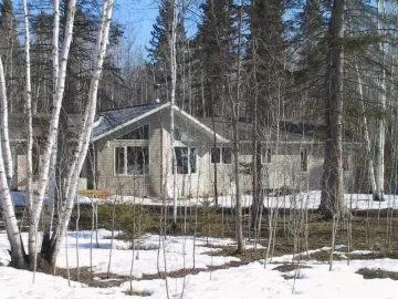

Thanks for the welcome...here's the best pic I have at the moment of the outside of our house.
I think it's time for me to throw in the towel on this. I made one more last ditch effort by having two fellows come to the house today, one a Certified Home Inspector the other a WET Certified Tech. The Home Inspector went through every posiible thing with a fine tooth comb and reports that there is nothing wacky with my house that could have caused this problem. Everyhing is working and venting as it should and nothing is creating a negative pressure in the house. He did however correct me on the grease thing. He says what covered my house is not "grease" per say but something grease or oily based.
The Wet Certified Tech checked and double checked the stove and stove pipe. He said all was installed correctly. He could not however determine wether the stove door or the stove itself is warped causing the door not to shut tightly.
As a final check we did an experiment. I have two large windows on either side of the stove. We made very sure the glass, casings and sills where perfectly clean. Then we lit the stove. Except for when the kindling started to ignite, there was no smoke and what there was went up the chimney not into the house. We had it burning for about and hour with both the furnace and HRV running and then let it die out. I then took a piece of paper towel wet down with a water/de-greaser mix and wiped it across the window glass and the frame and sills....the paper towel turned black. We repeated the experiment, this time without the furnace or HRV running...same result! One hour of burning and this brown film started to accumulate already.
When I wiped the window with a dry paper towel nothing came off on the paper. When I wiped it with a water soaked piece the window got smeary but nothing came off on the paper. When I wiped it with water/de-greaser mix the brown film turned black and and what ever this stuff is came off the window, casing and sill.
Neither Tech could come up with a reason why this is happening but both are certain the wood stove is the cause of it. Both indicated that this stove is malfuntioning for some reason and feel it is both a fire and carbon monoxide hazard.
Including these two guys, we have now spent over $1500 bringing people here to try and figure out this mess. You guys have been great in your brainstorming and to date..virtually no assistance from Osburn and certainly none from the retailer who sold me this stove.
I'm at my witts end with this and have no more ideas what else to do except send this stove off to the local landfill.

Just some observations from beyond the tree line of birch. I'll let the experts chime in on this one... Cause me ha...ha...ha...... Read the signature people
1) The cap opening seems kind of small for the size of the pipe.
2) Pretty close to the ridge vent (not sure if this has anything to do with anything at all)
3) can't see where the fresh air intake is on the wall
4) is that a protrusion in the wall (outward) between the 2 windows? and if so what is the purpose of it?
