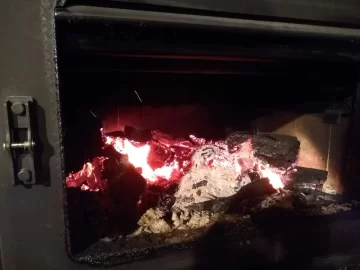

Have had Blaze King King for almost ten years now, had two a King, and a King parlor my current stove, nothing burns like a king, however the BK like dry wood, nothing over 20% the drier the better. Some fussing with bypass open and closing during startup but easily overcome, nothing in the stove world I'm aware of can burn longer a coal bed after 20 hours isn't uncommon. Once again the BK's thrive on dry wood, if you don't have access to that steer clear.Get a non cat .I'm burning wood at kiln dried levels now 7%, to 15% and the burns are still 12+ hours easily.
This is after 20 hours in my F5200 at was still at 300F STT.
