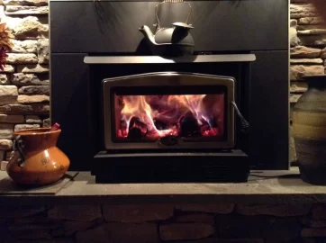

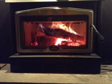

450 seems low. You should be between 550-650 for the most part. That isn't screaming. That is normal.View attachment 118172 Here is another. Stove is at 450 degrees. I have blocked off the air hole next to the air control, and the air control is shut down. If I didn't block off the hole next to the air control, this baby would be crying. Make that screaming,
View attachment 118170 This is my insert, with the air control closed all the way, and the bolt I installed into the air hole opening. It is under control, and I don't have a runaway firebox. Prior to this, this box would be lit up!
