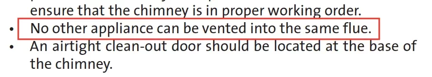

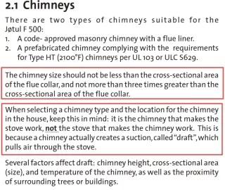

Yes, it could be diluting the draft and is in part why in almost all other states the wood stove needs a dedicated chimney. This is not a stove problem, it is a chimney issue. The chimney cross section is also too large for the stove. Read the manual. With a proper chimney the stove will perform much better. You risk severe damage to the stove by continuing to use the ash pan door for starting.

A. Chimney is too big to create and maintain a proper draft / pull to keep the stove running well. Says in the manual that it's designed for a 6" flu.
B. Sharing this flu with the furnace is a big NO for several reasons. Poor draft and CO poisoning are the main ones.

Yes, I remembered Maine being an exception, though the stove manual should trump that. The stove is not installed per mfg. directions.

Yes you want 6" liner. Preferably insulated if it's outside wall chimney.
