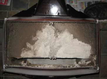

It didn't take too long to unbolt top using 10 mm socket wrench (back bolt is a tight squeeze for fingers) but it was easier than I thought it would be from reading previous threads. It really makes it easy to inspect and clean blanket and tubes and access flue. Had a thick layer of very fine ash on top of blanket after 5 burning seasons. Jotul manual has scant maintenance info.

  • [Hearth.com] oslo top question
