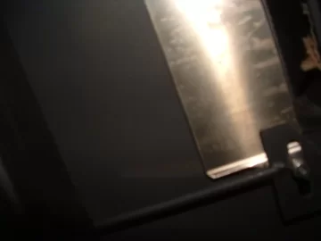

Can you get to yours to take a picture of it? Mine is a big silver piece of tin that even when closed hangs about a half inch below the stove and has a v notch in the back too for clearance i guess
Here is a pic of mine closed not a very good pic.

Mine has a notch not shown in this pic.
Is it possible that your air control plate needs to be tighter to the stove body? Can you post some shots of your air control in the closed and open positions?

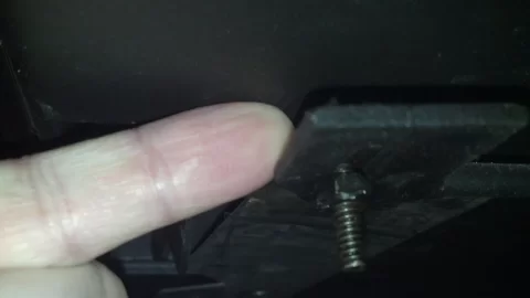

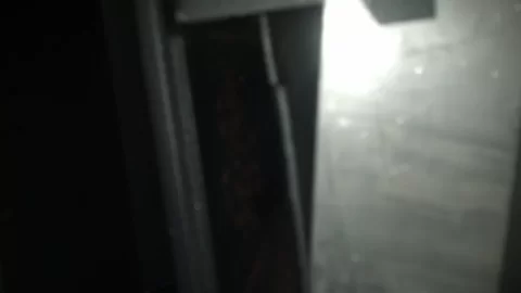

Not the best picts but you can see it doesn't close all the way and at full close it is still open about 3/4 of an inch on one side and i can i can get the tip of my pinky between the damper and the stove[Hearth.com] out of ideas

I'm still not clear where the actual air hole into the stove is. Is it where your finger is pointing or is it on the opposite end where the V notch is? It looks like the later. Is the air intake the long rectangular slot that the blade is covering?
