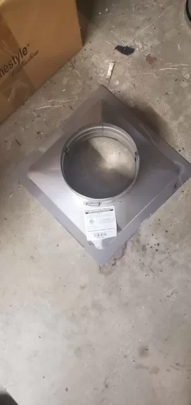

I'm sure I'm going to get scolded again somehow by everybody but here's the latest

FYI
My fire district told me NOT to wrap the liner in insulation. 1 run of bricks in front is enough. Both sides and rear have double runs
FYI
Did your fire district give you a written code variance? You also realize that is absolutely not how that insert is meant to be installed right?
Just curious how you plan on servicing it if that light wall liner burns out? I have found they normally don't last long on old stoves like that which dump allot of heat up the chimney
He is putting the plate in front of it. I forget what it called but it's a big huge cover plate that comes with the stove
But he is building the stove in a foot Infront of where the plate goes
It starts with the letter C..
My fire district does not like insulation on liners
Ok what testing have they done that over rides all of the testing that tells us insulation is needed to make the install safe? They don't just get to disregard the rules put in place to keep you safe just because they feel like it.
Remember when I questioned if your contractor knew what he was doing??? I now know the answer to that question.
