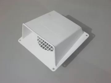

This is what is normally used. If you need smaller holes to stop insects, you could add a piece of screen to the item.

Thank you for this.
