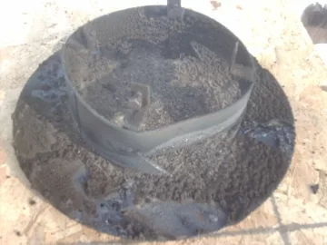

Ok so last night before bed i go down, load the furnace up pretty good for the night burn. Temp on the front mag. gauge was 300ish. I left the door open to let the fire get going and get the temps up. I let the front temp get to almost 500 before i closed the door and i check the back mag gauge on the uninsulated double wall stove pipe going into the chimney and thats 600+ degrees, the highest i have ever seen it and in the over fire zone.. So now im kind of worried, pipes smoking a bit and the smoke alarm goes off. So i cut the air back, run up on the roof and look, the chimney cap is glowing in spots where the creosote started to catch fire and burn, there a few sparks coming out the chimney but nothing bad. I go back downstairs and by this time temps are back down in high end of the normal range so i crack the air open a little bit , wait awhile and go check the chimney again, the smoke looked thicker than normal against the night sky but i couldnt tell in the dark what color it was. I watched it for awhile, temps all back in normal range everything seemed fine so i went to bed after awhile. In the morning i figure i'll clean the chimney, it was a few days past due anyways. I always clean it once a month and i usually get a coffee can of creosote out of it without fail. Past couple weeks i got into some wetter wood so i figured it'd be pretty bad. I pull the cap, clean that, look down the SS liner and im shocked at how clean it is, didnt even need cleaning when it should have been dirty as hell. So now im wondering if i had an over fire or if i had a chimney fire and it cleaned the chimney out? Nothing laying on the roof top besides a little creosote from the cap. No flames shooting out, no loud rumble, no mess on the roof, no bitter smell. I just cant understand why the liner was so clean. The first two pictures are from today, the 3rd picture is what my pipe usually looks like after 30 days of burning. Only thing different is last few weeks i have been burning more ash as part of the mix but like i said its a bit wetter in the low 30s. Prior to that it was box elder, aspen, some pine & maple all in the mid teens.
Bare spots on cap are the areas that were glowing and on fire.

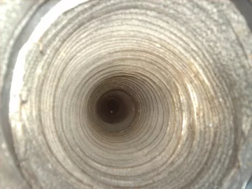

what my liner looks like today after 32 days of burning. [Hearth.com] Over fire or chimney fire??

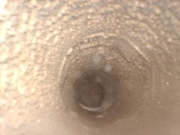

what my liner USUALLY looks like past 6 times i have cleaned it in the past. [Hearth.com] Over fire or chimney fire??
IMO, if your cap got hot enough to glow & catch fire, you cooked everything else out of the liner. If you cut the air off to the furnace and there was not enough O2 in the flue to support combustion, the heat, soot & creosote just went up the flue and when it hit the atmospheric O2, the cap lit up.
Maybe your prior dry wood was burning pretty clean, and it was the recent wet ash that coated only the cap.

cap started caking up soon after the last cleaning, like it always does. If the wood was dry and clean its the same wood i have been using all winter so far, the 3rd picture is what my liner looked like last months cleaning, same wood.

It sounds like you caught it just in time and got it under control. The cap was starting to burn, a few sparks, then some thicker smoke. I'd say the liner was still hot enough to vaporize any remaining creosote and it drifted off in the night.

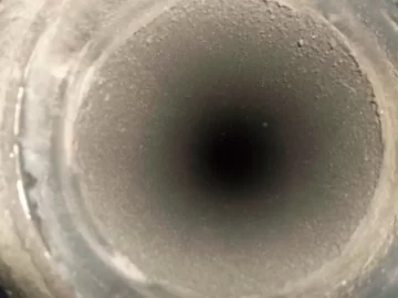

With the Jetstream, this is what the chimney looks like after almost 3 years since the last cleaning, just fly ash.

well if it was a chimney fire it was over real quick and it cleaned the liner perfectly top to bottom. If it wasnt for that "miraculously" clean liner i'd argue it wasnt a chimney fire but thats got me stumped. A hot pipe and a (very) few sparks were the only sign. Well if it was, at least it withstood the stress test( not that i want to do it ever again). I hate that stupid furnace.

I haven't had to brush the flue in 19 years,since I bought the Jetstream.I get about a liter of fly ash out of the cleanout every season.My flue used to be coated with creosete,a fire waiting to happen.Scary when I think back.
Considering the light coating your flue normally has, I'd say it would burn out quite quickly leaving it cleaned out as shown. The sparks are a pretty sure sign of a chimney fire.
