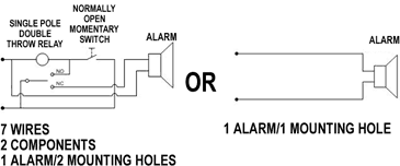

international5288 nice setup you have. A few suggestions for upgrades, check out (broken link removed) they have some low cost piezo alarm buzzer that run on 120VAC you could get rid of the 9 volt battery.
For a few bucks more you can get one with a flashing light.
Also you could add a relay and a push button switch to silence the alarm, it would reset when the alarm output turned off.
I have this feature on one of my temp alarms, it is very handy.
see pic
