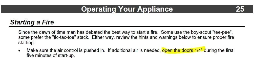

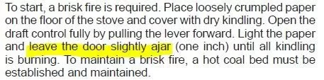

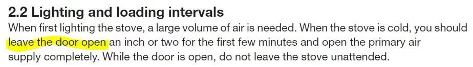

FWIW, aren't many fireplaces open to the room?
  • [Hearth.com] Oxygen starved fire or so it would seem
