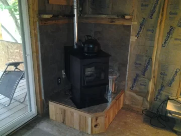

traded p38 for a p61. any advice on hookup, will the vent be in the same place?
  • [Hearth.com] P38 going P61A coming
The P38 exhaust flue collar is at 10-1/4" Centerline from the floor. P61 is at 10"...Depending on your pellet vent configuration, it MAY hook right up...
