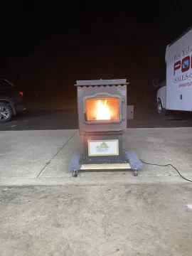

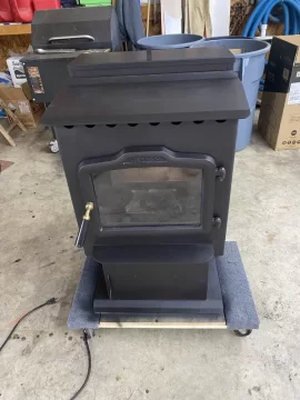

I pick up this stove at a decent price. It was ugly, had a stripped door handle and needed pulled apart and deep cleaned. All motors sound like sewing machines. Because it was a manual ignition the auger and tube are in mint condition. The Auto light stoves are harder on auger tip and tube from fire burning down and going out many times a day. manual light keeps fire up away from auger and tube until you shut it off. Plus the manual light Harmans dont bring much. I have parts ordered to bring it up to Auto ignition. Once it is done I will try listing it on Marketplace and see if there is any interest. I know I kinda missed the used stove sales window. If it dont sell I will hook it up in the barn.

She's a beaut. Auto ignition with certainly make her even more desirable.
Nice find, looking forward to seeing the progress! I think doing these will be my new summer projects and love to see what others are doing.
Nice. Post your progress..

I would have to partly disagree. If you watch the stove go out it burns the pellets up back into the tube about 1/2". So yes a low fire is in fact what causes the burn up. With the stove going thru several to many shutdowns and idle fires through out the day it puts the auger tip and tube in the fire heat way more than a manual ignition stove. Manual ignition stoves only get the fire down that low when it goes thru a shut down. I 1000% agree it is worth the shorter auger life for auto ignition . Plus the cost savings in fuel well makes up for it. On the flip side, if you dont keep a eye on it you will end up with the feeder tube wearing thru which is pretty costly. The stove I am working on is a 2004 I think and the end of the auger flight is still squared off.
Still waiting on parts. Burn pot, Circuit board and circuit board plate have not shipped yet. I guess Harman is not shipping circuit boards until January?:eek: We only have 2 in stock and dont want to risk possibly leaving a customer hanging
