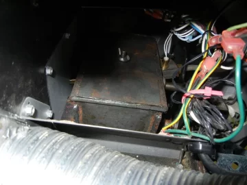

What is the fines box? Is that different than an ash pan?
The fines box is behind the right side cover toward the back of the stove (as you are looking at the stove). You have to take off the cover, then loosen the big wingnut that is inside to remove the fines box cover. You will find collected sawdust that needs to be cleaned out once a month or so (depending on your pellets and burning style).

Shot at one on a PC45 with room fan remotely mounted
