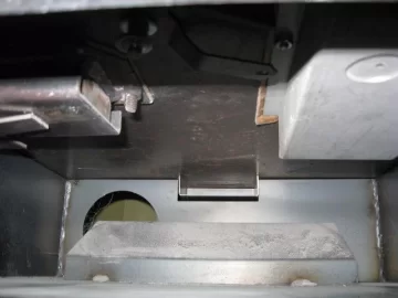

Any pictures??
The box that covers the "ebt box" has a gasket on it...I figured it was that way for a reason, did you notice a difference now that the "ebt box" is no longer sealed.
Just so everyone knows what we are talking about, the EBT BOX is on the right in the pic.
  • [Hearth.com] Pacific Energy "EBT"
yes thats the EBT.the valve is the one with the little hole in the middle(that little hole is so the draft doesnt open the valve).also inside the spring is in a different chamber.this way the cooler air going into the valve side chamber doesnt affect the temperature spring.anyways on mine it also has a plate covering that hole.i thought you were talking about that?i even took the fiberglass gasket off and sealed it with high temp sealant.this way the heat would transfer to the EBT more and open the valve earlier.
